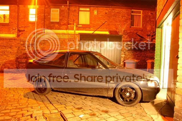

over the last few weeks i've changed bottom end shells as it had an ever so slight knock, so better to be safe than sorry, full rollcage has been fitted into car, jsut needs plates welding in, interior totally stripped, and today some stage 2 cams have been fitted.
over the next few weeks the wheels will be painted satin black, car will be ran in and and have another oil change, cage plates welded in and jsut alot on general tidying ready for the vernier pulleys and remap on the 29th December.
will update wil lots of pics through the week, jsut got 2 tonight myself of a painted wheel we tryed to see what it looks like and a nice polished mocal oil catch tank.
