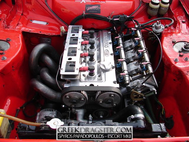

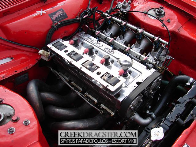

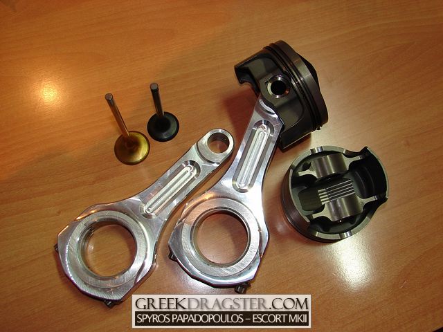

Its a YB Cossie engine destroked to 1914cc. Its has custom rods, Supertech custom build pistons for compression up to 17:1. The crank is steel again custom made. Dry sump. Throttle bodies and exhaust again custom made. It uses stand alone engine management, the Haltech E8 with sequential injection. Of course there are a lot of other technical specs which are not published....

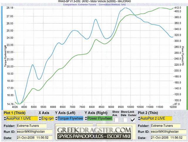

Dynosheet from a dynopack dynamometer
Maximum power is 412hp @ 11500 rpm και 28.18 kgr torgue @ 9700 rpm with MotoGP fuel.

whats mounted on the left side of the rocker cover?

The fuel makes all the difference in the world. Anybody have any info on what is MotoGP fuel made of? The coating is standard anti-friction coating as in all quality pistons, like the ones in my Zetec turbo

Awesome car, but 211lb/ft of torque is a HELL of a lot for a 1.9 litre N/A engine.... is that even feasible?
I'm not questioning that there's clearly loads of development work gone into it, and it's a very impressive lump, but I've always been under the impression that even on a normally aspriated full race engine with £££££££££££s of development work, over 100lb/ft per litre is simply not going to happen.
