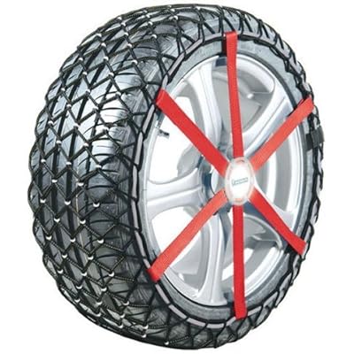

Id invest in a set of snow chains as well to get up the slope.

i used a set of snow chains for the first time int hat bad snow a couple of years ago, they were fucking brilliant!
but your limited to 3mph or less really. was very funny passing everyone on the duel carrageway in the outside lane in 2 foot of snow. unit i got on the motorway and there wasnt any snow in lanes 1,2 and 3...
but there was 2 foot on the hard shoulder, so if i had stopped to take the chains off, id have got stuck....
so everyone went back past me as i could only do 30mph for about 20 miles
