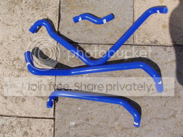

these are the hoses i have left over???

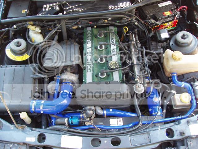

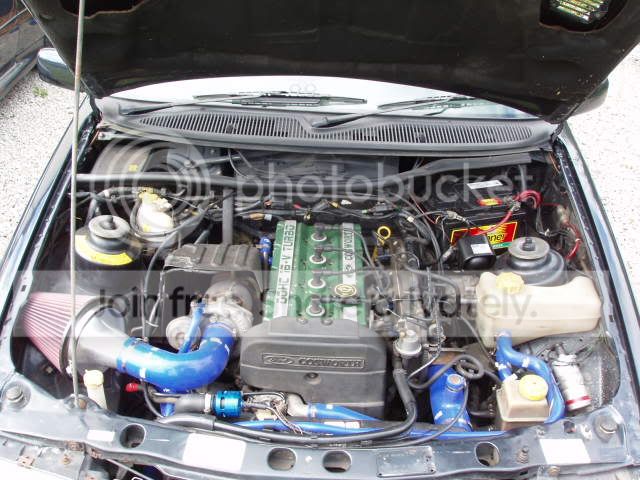

these are the ones i have already fitted myself who is no good with engines but have managed this far which is probably rubbish lol

The 2 long 1's come off ur oil filter housing underneith your inlet manifold and the other two go to ur heater matrix, and are just above the exhaust manifold at the back, just in front of the bulk head
ps move ur dump valve to cold side yoof

Hi,
Theses are your hoses.
Regards.
Claude

Easier way to go about it is...if its black...swap it for a blue hose thats the same shape
