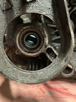

Hi can anyone tell me if this is an lsd box, seller says it is but i was under the impression if there was the bar across where the shaft sits there was no lsd, no bar =lsd, sorry been away from these things for a long time (11 years ish)

You are right in saying no bar =lsd

Cheers bud! Nice to know i havnt completely forgot everything!

As above, thats a non-lsd box

Glad i didn't take a punt on it then till i got the picture, was advertised as am rs turbo box with all the abs attached, had either been swapped over the years for a 3i or something, or the seller was being a bit crafty! The search goes on!
