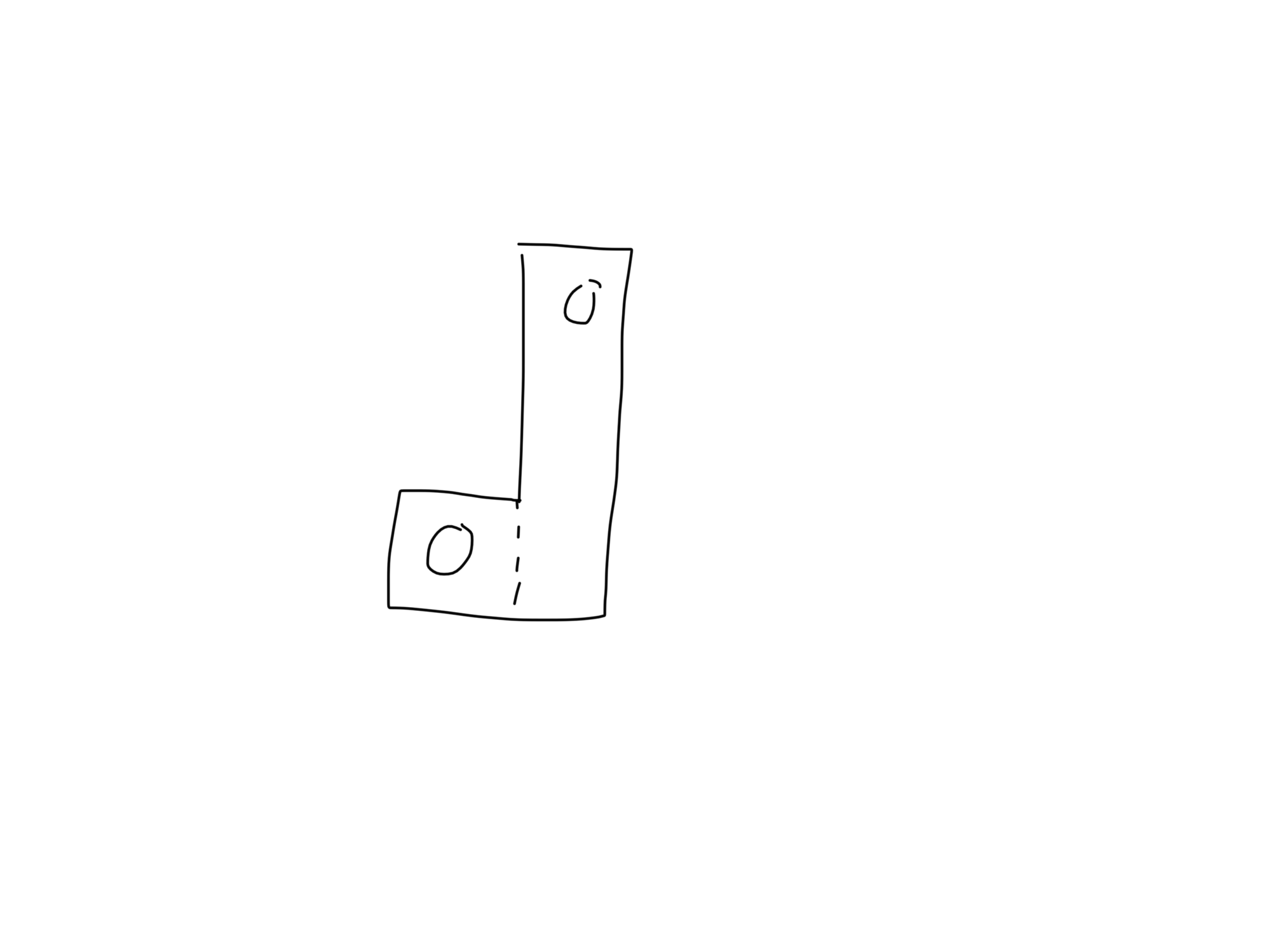

You need to mount the stack sensor on the front wheel hub, it can be set to read 4 bolts so it will see the 4 backs of the wheel studs on the back of the disc, i made up a tiny little bracket, if I can find it I will post it to you as I no longer run it on my Wrc hubs. It is simple though.

If you cut an L shape like this pic, drill the straight end last to the size of the abs sensor bolt and then fold at dotted line after drilling hole for the sensor and then hammer it to the contour of the hub.
