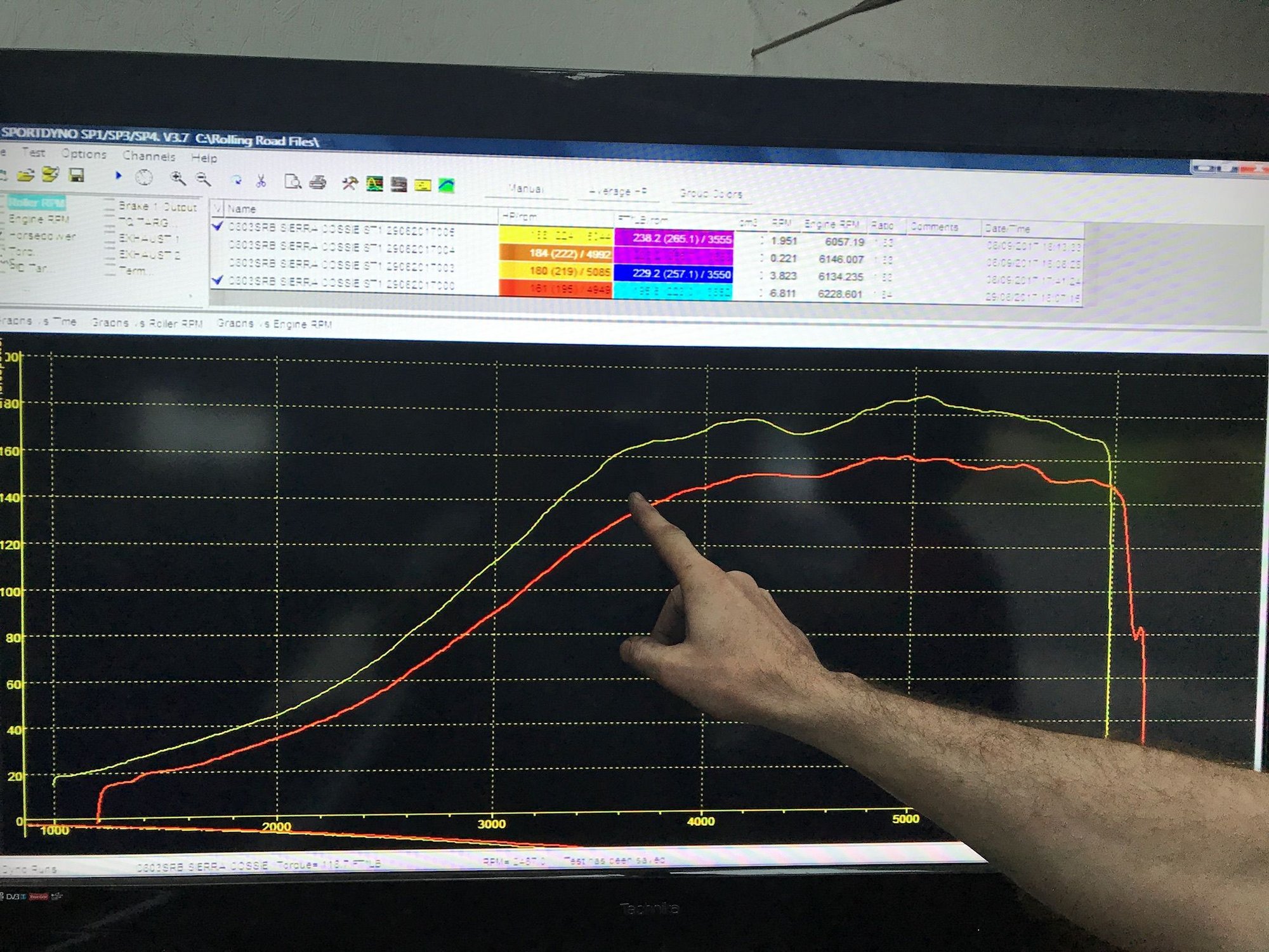

Thanks James, I will check everything over. The injectors are standard yellows which were refurbed about a year ago. Maybe they could be at fault? The car has a new engine loom, fuel pump loom, wasted spark and all sensors are new. It holds 1 bar boost pressure under load but runs very rich. Strange one if a stage 1 should not run this rich!
Wish I lived close to a reputable Cosworth tuner to get it sorted.
Here's last nights graphs to see if that helps.

The new looms etc will certainly help with maintaining battery voltage, which will help things, did you try an extra 2psi of boost to see if the AFR started to correct? it will be on the top line of the map at 14psi, and on a stage 1 will be heavily using the WOT adders too,
You should set your fuel pressure to 3.5bar with the vac line disconnected.
The fact its up under load shows it is raising rate.
Do you have an AFR plot?
The next step would be to drag some data from the ECU to check all the sensors are operating well and calibrated ok,
If all is well, the fix is quite easy, if the AFR is good everywhere else, a simple reduction in the WOT table would probably fix the issue.

We do not have an afr plot, we used a handheld device to test afr under load.
I've also not tried adjusting boost pressure to see if this helped. Do you think this could be all that's at fault?

It would be good to see an AFR against Boost plot really to see what is going on, certainly worth a test to add 2 lb of boost and see if the fuelling starts to level out.
max of 4mm preload on the actuator, the rest to be done by jetting the amal valve, if the boost is tailing off it may explain it, so if you can get it to hang onto some extra boost at high RPM the fuelling may correct.
all that graph shows is a dirty finger pointing lol

Ha ha, I thought it may be useful but it seems not!
you need a boost and fueling plot show rpm to be able to get any useful advice
