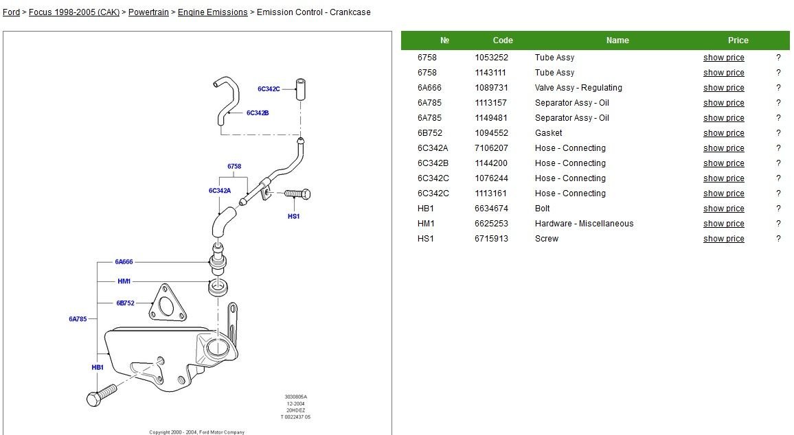

Use this site for all your part numbers!
http://eucatparts.com/?action=cat_ford
Old Dec 24, 2015 | 02:25 PM
Pitbull69's Avatar
Pitbull69
Joined: Feb 2014
Posts: 185
Likes: 14
From: Murton
Thanks mate, so looking at this, I need a HM1
Old Dec 24, 2015 | 02:33 PM

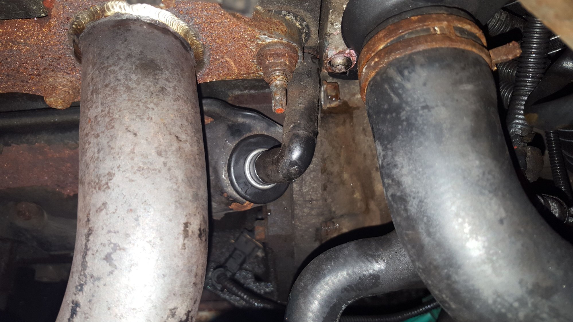

One brand new PCV and grommet now fitted, With slightly mashed fingers, (was right about the tighut space lol)

I was debating waiting till the cars in the garage in a few weeks having manifold swapped and decat put on, but managed to put a flat head into the side of the grommet and it lifted enough I could get a grip with the pliers, wasnt worried about damaging the grommet knowing it was being replaced,
But its all tight and fitting snug now, so hopefully wont need to be touched for a while now,
