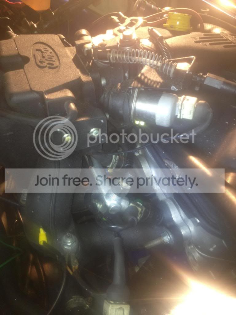

Right I have re shelled my s2 adding l6 management. ATM when I turn the key there's a lot off clicking under bonnet but the fuel pump doesn't prime like it use to.
When I turn ignition 1 click I get a single spark on plugs then as the engines turning over I don't get a spark through the plugs. But if I have a plug in the king lead I get a spark .
It won't run and if I'm lucky it will start for a min n run like utter shit.
I have took the injector rail of and is spraying fuel also when I am turning engine over oh then does the fuel pump prime

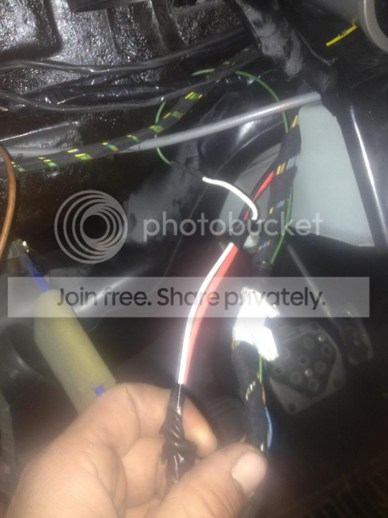

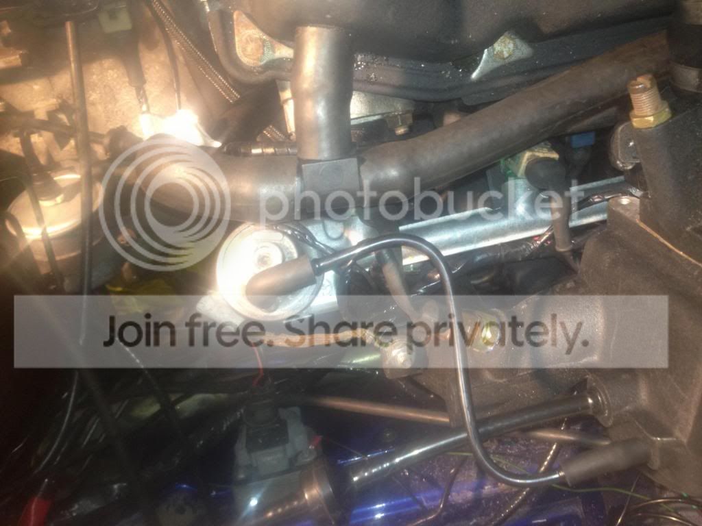

This is the three wires that connect in the car.
I had real trouble trying to get this to earth
