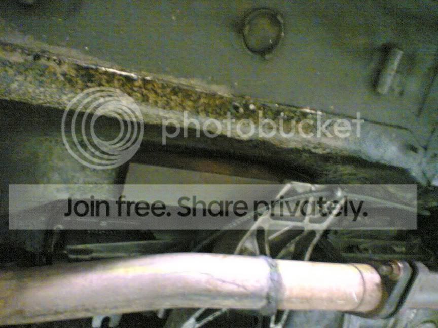

sorry to steal the post but does any one have any photos of wich part need welding or cutting or makeing to turn a 4x4 in to 2wd as i was told will need to make a braket for the gearbox to bolt up to the body or is this wrong thanks

abdr500,
this pic shows the 2wd gearbox x-member as fitted to a 4x4 floorpan. where the x-member should bolt to the floor there is a space for the transfer box
to make it fit, bolt a length of 50mm box section onto the one mounting place that extends forward to make a mounting place for the x-member.

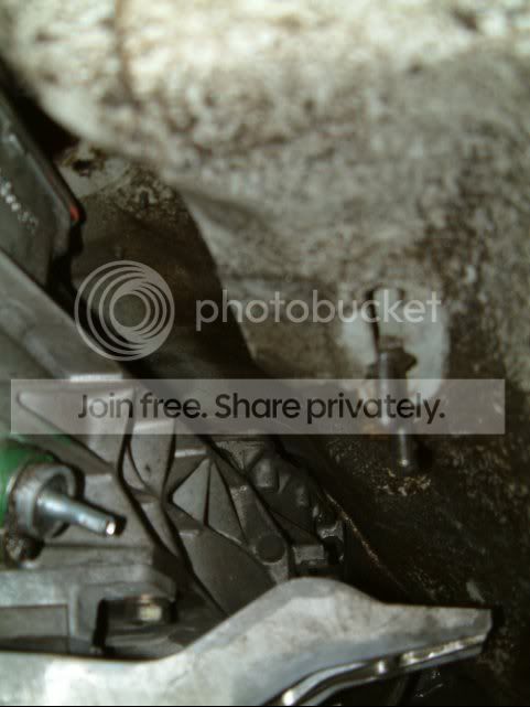

Old Aug 30, 2009 | 09:10 PM
forevaford's Avatar
forevaford
Joined: Mar 2008
Posts: 473
From: brierley hill
umm, im just converting my 4x4 saph to 2wd this weekend and came accross this gearbox mount problem, do you have to weld the box section to the floor pan?

From: W. Sussex
i bolted it up using the original mounting bolts but the nuts are a bit fiddly to get to inside the box section. it was so long ago now though that i can't remember what i did exactly. i think i cut the box at an angle at that end.
