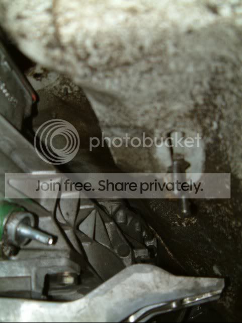

it's been covered on here before mate, do a search.
tunnel is different. 2wd t5 and crossmember will not bolt to tunnel. see pic below
bolt a length of 50mm box section to the front mount running backwards at a slight angle and then it's sorted.
apart from that, no probs.
