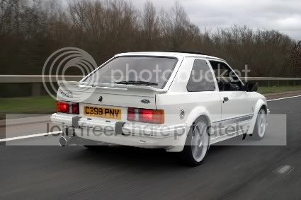

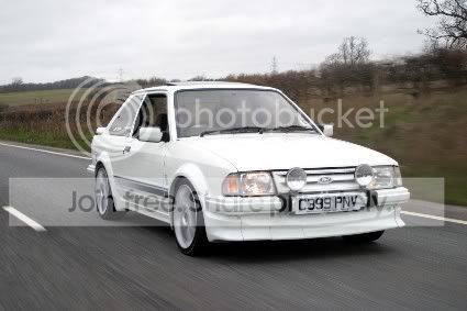

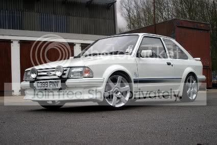

Thanks mate. I just cant find many pics thats the thing!
Pic of a S1 on cossie rims would be superb ;o)

17 inch is no problem, if the width of the wheel doesn't increase much. Try not to go wider than 7 inch and you'll be fine with 40 series tires and a ET of 35-40mm. Watch out of the width because most 17 inch wheels come with a width of 8 inches.
