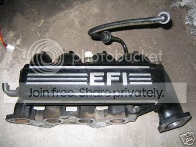

Originally Posted by JeroentjeRS
I rover inlet? is the std zetec inlet not good then? AS the rover inlet doenst fit either
The standard ZETEC inlet is rubbish for NA. The Rover turbo inlet fits if you make an adapter plate.
http://img.photobucket.com/albums/v8...overinlet3.bmp
http://img.photobucket.com/albums/v8...overinlet2.bmp

Yeah or make a good zetec mani that fits without adaptor plates etc.
