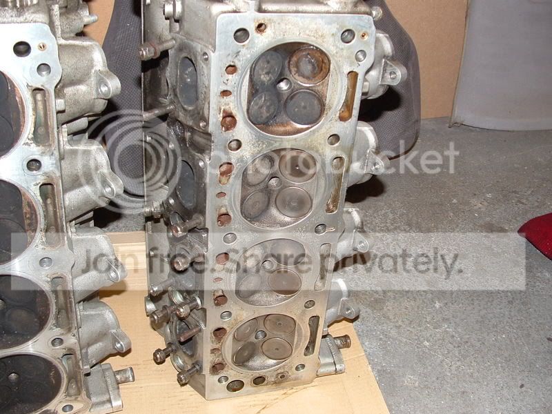

Old Dec 26, 2006 | 07:20 PM
costina's Avatar
costina
Live long and prosper!!
Posts: 9,158
Likes: 373
From: area 51
Here are the different Heads
3dr Head with large water jackets (exhaust side)1st pic
Late saff 2wd Head smaller water jackets 2nd pic
4x4 Head same as above but with no turbo hanger and revised front cam caps, and oil supply to turbo on head as mentioned before this head has smaller comp chambers but also gives better torque 3rd pic
Old Dec 26, 2006 | 07:43 PM
2wd's Avatar
2wd
Posts: 777
From: Denmark
super....I'll have a look as soon as i'm home tomorrow.
so the one's to use is the late 2wd or the 4wd head.
thanks

Old Dec 27, 2006 | 02:17 PM
2wd's Avatar
2wd
Posts: 777
From: Denmark
hi ..just checked it..and it seems to be a early type 2wd head I have .. like on the first (top) pic of the heads. hmmm.I was hoping that it was the late type as I could then send it out , and then just "make a quick swap" when it was back....now I will have to take my car of the road til its done..... I wish I had the ŁŁŁ now so it could be done while it is winter as it is off the road until april ...
