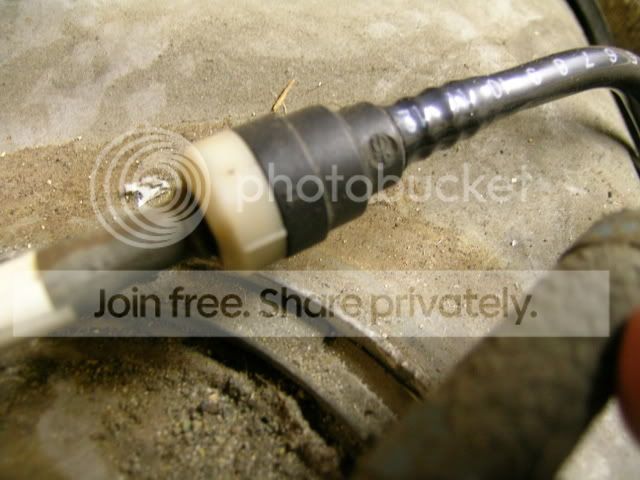

Mk2 orion same on the mk4 escort EFI
this is off one of the pipes to the fuel tank how the hell do you get them off and even back on again????
do they come apart or is it once attached brake off and get new
any info greatly apprecieated

try pushing the part just infront of the white part in with a screwdriver and pull the pipe as you do

i just found how to do it, its a fansy clamp with teeth clamping it on to the metal pipe just have to wack it off

yep - you need a spanner or pair of plier that fits around the pie so that you can push the bit coloured in red backwards while pulling the pipes apart - you might need to spray it up with wd40 to clean out the grit from it first

As above, however i find 2 small screwdrivers best. And the other thing ive learn't is to use the screw drivers not only to push the clip in, but to also push the pipe off. Pushing with screwdrivers/your designated tool and pulling the pipe doesn't seem anywhere near as effective, and ive struggled with a lot of these

thanx im gonna make up a tool tho so i dont end up damaging it

A tool will always be handy, but being realistic its very hard to damage them if you use a couple of small precison screw drivers. Just for your info, presuming your car is EFI, look at the clip holding the brake servo pipe into the inlet plenum, they are exactly the same
