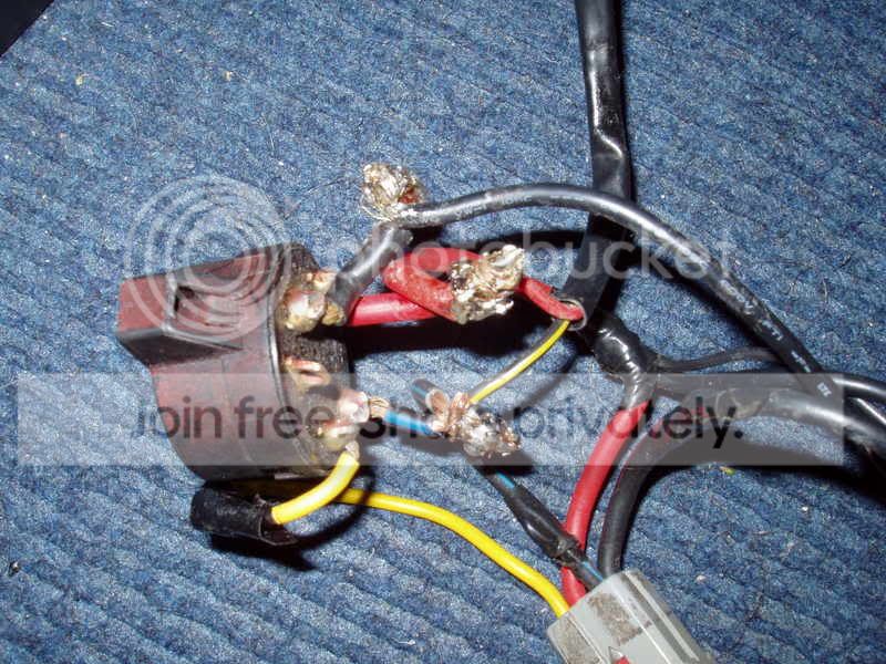

Lol, while i was thinking of it, i removed a concept 300 from a MK4 a while back.....and i think your comment about poor fitment was a little below the belt mate.
Can you see anything wrong here...........
Looks all good to me
