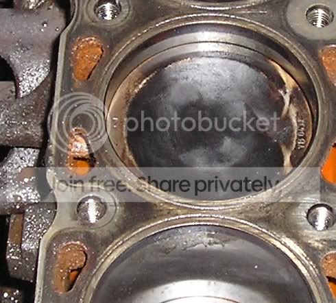

is this wire ringing could anyone advise me on what type of head gasket for rebuild and where to get it

If it's just the thin line of wire in the top of the block then you are limited to using a Group A gasket(WILL NEED THE WIRE CHANGING ALSO) or you could have the block re faced and then you could use WHATEVER gasket you wanted to use!
the latter would mead having the pistons machined down also!

was no wire ring in it was cosmetic metal gasket on it
