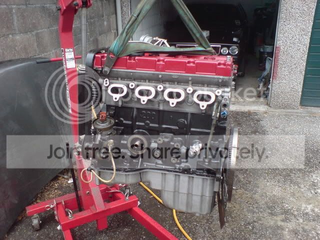

well after an 8am start its been a very long day and not nearly as productive as I wanted, I started by stripping off parts of trhe new engine that I didnt want like the 2wd water pump and thermostat, this all took place with the engine still in the boot of my trusty rusty vectra. One of my friends arrived a few hours later complete with engine crane which was handy, we got the engine out of the boot, gave it a clean up, swapped the sump and all the other 4wd ancillaries that wheer required and got the engine and box back into the car, I still have the job of connecting all the water fuel electrical and power steering so a few more evenings and it should be running.
I will get some pics of engine in car once its a bit further along

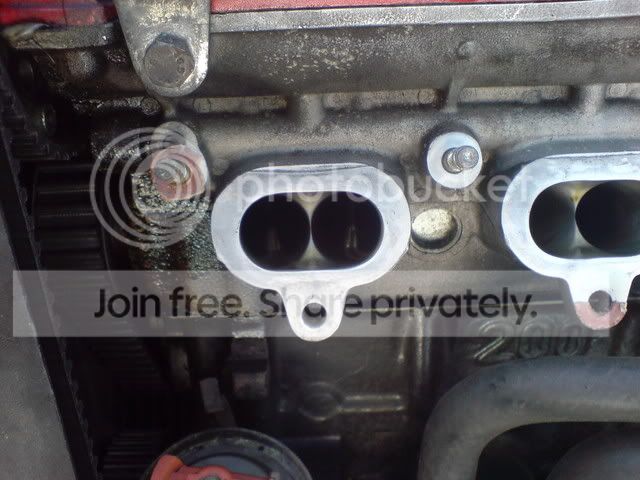

Nice one Trev, didn't know Harvey did the ports on the 400/400 engine

I have no idea what should and shouldnt be done, the head is done though and looks pretty good to me, the block is also long studded, Arps in the bottom end etc

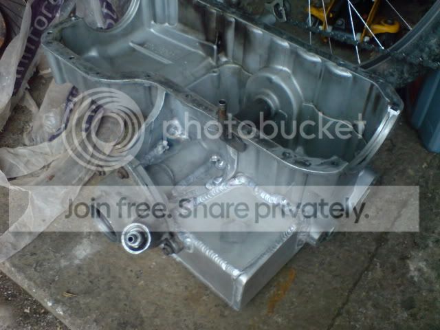

IT RUNS, well it did for about 10 seconds before I noticed a massive oil leak from the modine bolt, this will be sorted tomorrow with a new dowty seal. all thats left to do is the dowty seal, the boost hoses, 2 water hoses, fill with water and anti freeze and pas fluid, re fit exhaust and test drive

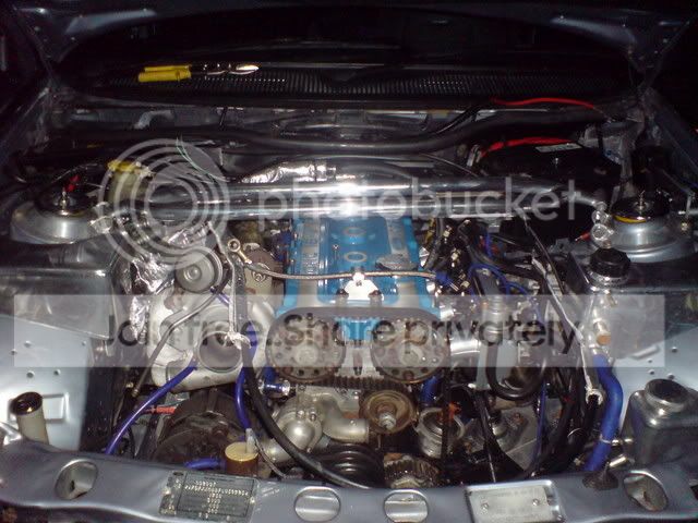

Well the car made it to combe and back with no issues, I tightened the plenim bolts up and all the boost hoses on saturday morning at 4am car didnt use and oil or water didnt smoke or even miss a beat all the way, bit of an issue with the front prop hitting the downpipe so this has to come off for a bit of modding, here's a quick pic of the car on the Devon and Somerset stand.

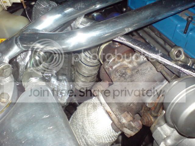

After asking for some advice in genaral discussion and Martin kindly telling me that the answer to my rubbing problem was to cut the front pipe about so I did the following
Chopped it up
All welded back together
purchased some new wrap, some new front prop bolts and a new mikalor clamp and some stainless tie wraps for the exhaust
re wrapped
Fitted and pleanty of clearance
And at last I can drive it without it bloody rubbing
