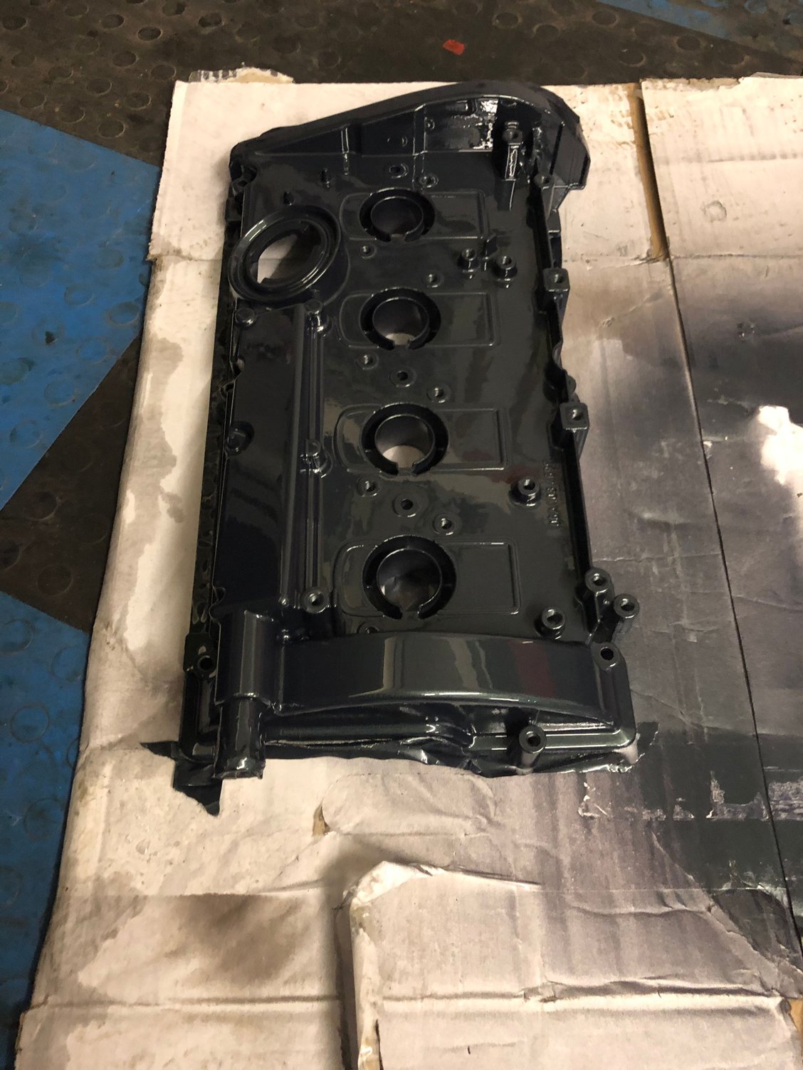

My car has a carbon cam cover...cover but it has seen better days so I may run without the extra cover, if I don’t like it I will buy an oem one but seeing as I had throughly degreased the cover in the ultrasonic bath I though I may as well paint it in 2k and lacquer.
It is metallic green, like the car but doesn’t look it in the light of the photo. I have orange boost pipes to contrast like the baseball leather.
