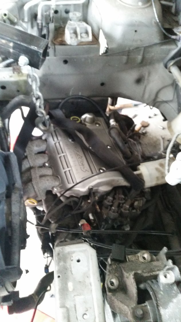

I'm new here but not new to fords. About to start building a puma powered ka, stripping the puma first then the ka. Also swapping the dash to a later ka one.
This is how i got it. £140 well spent <br/>
And here's the puma

Cheers. Nothing really new to show today. Got the puma loom out though

Rest of the loom and engine out today

Got some more done to the ka. Gearbox built engines in and running, loads of fiddly stuff to do yet but the majority is done

This was a few days ago its more complete now

Top job matey. Is there much room for the radiator. Will you be ok with the wiring.

Yeah the rad just about fits had to get a slimline fan, got most of the wiring sorted, few odds and ends left still
