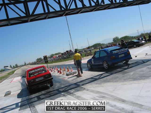

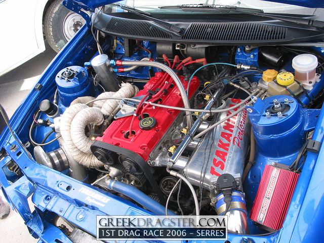

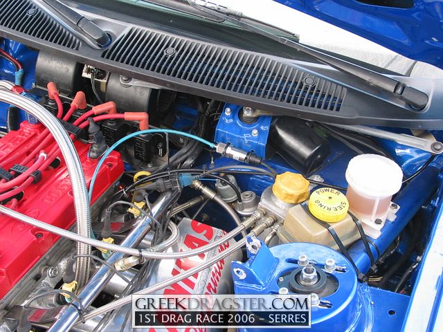

I can say that its a 2 liter bottom end, HKS T51R SPL turbo, sequential gearbox, fully caged chasis...
First time out racing it managed a 10.576@219km. Here's the slip
0-18m - 1.841
0-200m - 7.010
0-400m - 10.576
speed - 219.10 km
The car ran full interior on slicks. This is a 9 second car when is done...!!!

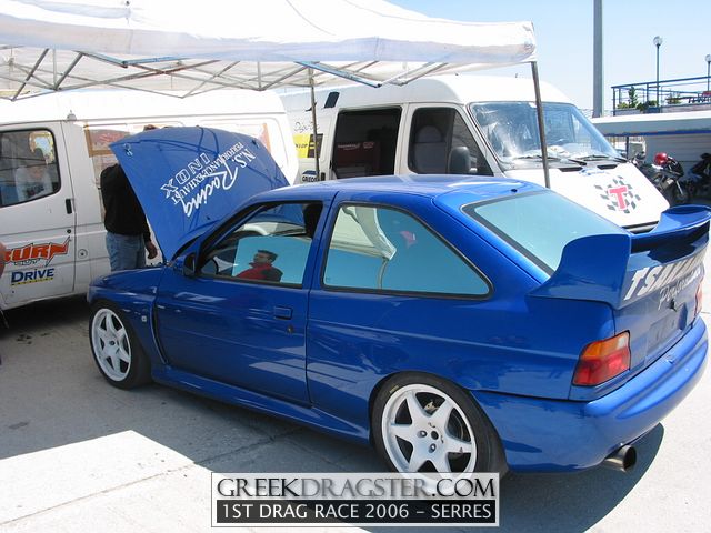

Why would you run it with a non-Cosworth bonnet? I saw that too
Seriously fat boost pipes on that, loving the inlet too. Bring on the 9s!

wheels look like the new mo's kev
the turrets have been modded so the top mounts are adjustable (camber/caster) from the looks of things.
Also the cam cover looks to have had the raised bits round the spark plugs milled off..... i am guessing for different leads
