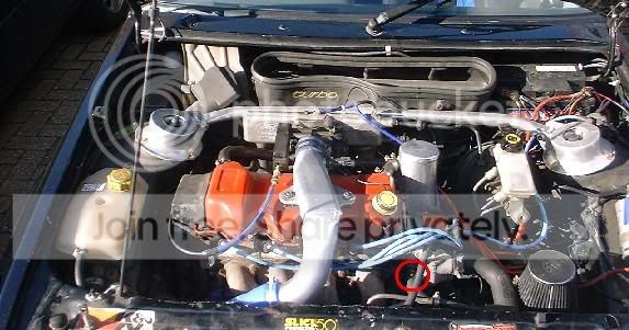

Check the pipe that goes from the front of the thermostat housing and curves round to the baclk of the engine. Mine split and I couldn't see it until I fired the car up and it got nice and warm whereupon it pissed out.
Will try and sort a pic

This is the pipe that split on mine mate. HTH
