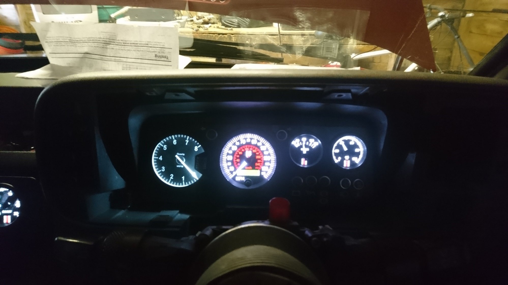

Delighted with the way it turned out, will get her fitted tomorrow, most off wiring complete

Nice job...assume you will make the dials all square as they are at odd angles now
Old Mar 10, 2017 | 06:19 PM
Rsturbo519's Avatar
Rsturbo519
Joined: Mar 2014
Posts: 136
From: Scotland
Yes haha, you just spin them with your hand, they have locking nuts at the back, come with all gauges

Cool, get some pics up of it in the car. How did you do the warning light graphics? They look really good
Old Mar 10, 2017 | 07:44 PM
Rsturbo519's Avatar
Rsturbo519
Joined: Mar 2014
Posts: 136
From: Scotland
I will get pics over weekend, I bought them on ebay and cut them out. Happy with it, I made a mistake tho and didn't cover the original warning lights, originally I was going to keep them

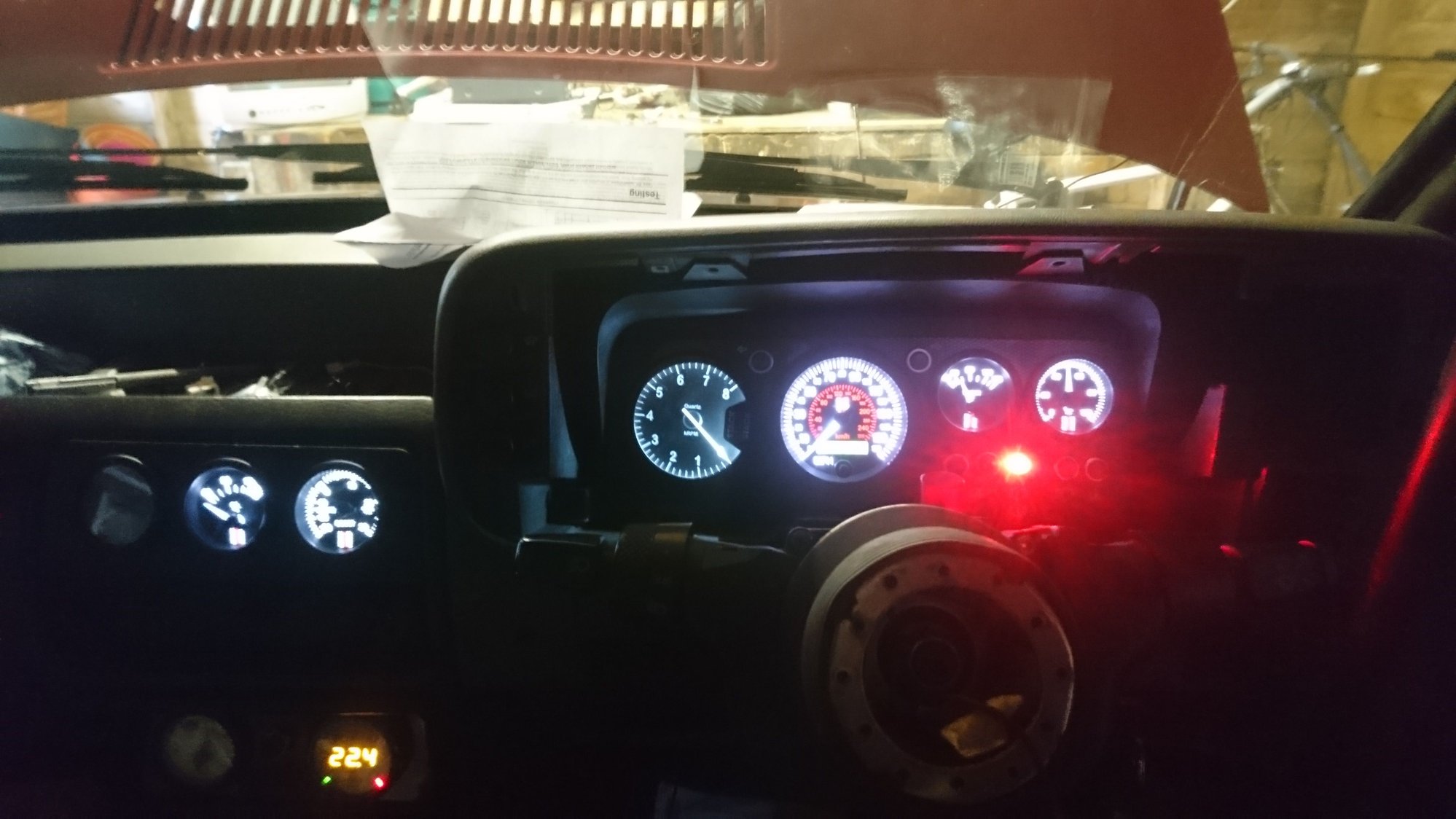

That's them fitted, just need to get tacho working,

Looks good. The tachometer just needs a wire connecting doesn't it?

Ye caddy I only tried quickly to do it before I'm having a nice cold beer now, but what I thought was going to work never. I have a stinger v4 ecu so I connected it to an auxiliary wire, then went into the ecu and selected tacho output on that wire and it never worked. Any ideas? Is it a voltage that wire should see or is it done through earth???
I think the stinger is a cut down vipec? I have vipec but I wired the stack tachometer first....I can look it up but think you can pick up off coil (I don't have one) or alternator...it is in the stack manual.
The toucan display can read off my vipec too.
