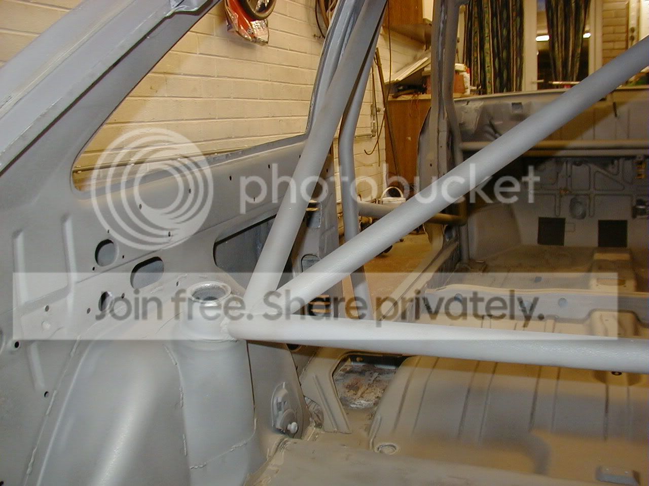

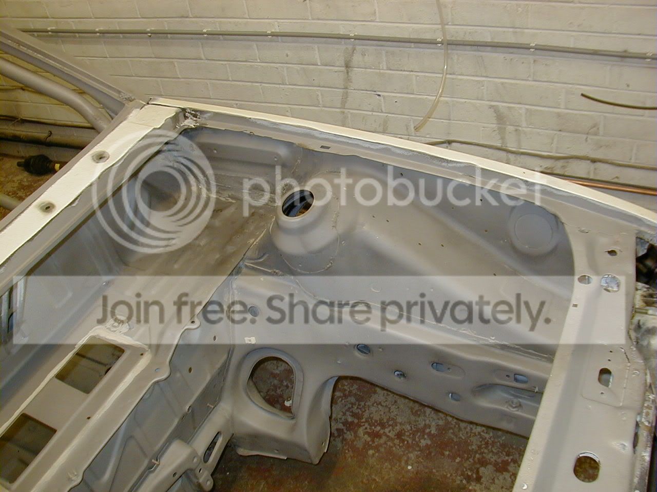

I thought Ł40 was dear as it was mates rates Came back looking like new tho and allowed me to get on with the seam welding without getting smoky burning paint marks everywhere
Under bonnet / battery tray area
Fuse box area
Inside rear
I had the car on a revolving stand whilst doing the other work and sand was coming out of it for weeks afterwards but it was WELL worth it
Fuse box area
Inside rear
