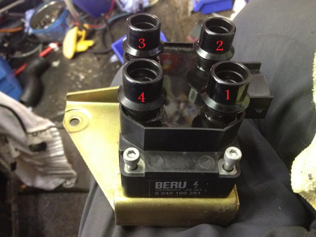

I've converted my rst to efi using omex today.
I don't know the arrangement for the ht leads as there is nothing written on the coil pack.
Anyone know where they go please ?
Here's a pic

With the plug at the bottom of the coil pack:
Bottom Left = 1
Top Left = 4
Bottom Right = 2
Top Right = 3

You were right. She's alive
Thanks again
