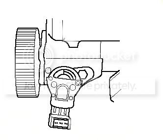

on the small t es cos what are you supposed to see through the small window in the sensor and how exactly does it work? and line up etc? these things seem to be a bit of a mystery lol

the line on the window lines up with the black line underneath, the bit you need to line up is the point where the line gets thinner.
edit found the pic

there is a raised lip inside which goes about halfway round so presume you line it up with the tail end of this? where did you get the pic steve as i cant find any info on these

line it up as the pic explains the line on the window with the end of the solid big line just where the thin line starts.
use a torch and it's easy
