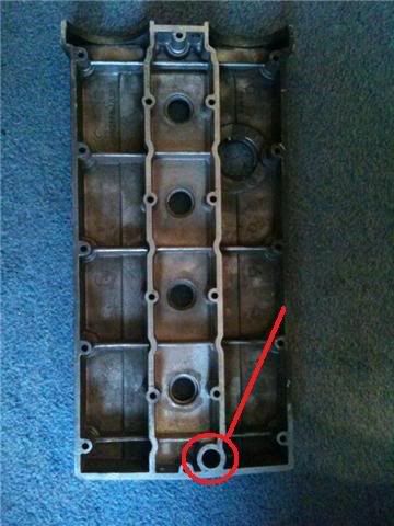

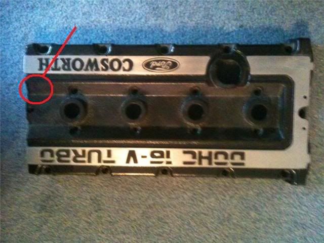

Cam cover can I....
cossie fan (unluckerly)
thats what u are meant to do (drill it anyway u will not knock it out lol) i did it at work with a hole cutter in the pillar drill as a drill bit that size is very expensive to use once
yeah just go easy and take your time should be ok as hole cutters come with a piliot drill in them just measure the breather hose adapter with a mic and get the same size cutter
not really how will that fit inside the guid tube on the inside on the rocker cover and if he dose it from the other side how is he going to know were the middle is! a hole cuter or the right size drill bit will be best lol but as i said a drill bit that big is expensive for one use
As said expensive if only doing one to buyt a suitable reduced shank bit.
Would only cost a few quid to get done at a engineering place, as they wil have this size or similar bits.
I use bits larger than this in the lathe, but these are 13 shakes reduced so would fit in a ordinary drill, I use blacksmiths drill bits up to 55mm.
If doing yourself just drill pilot dead centre(as best you can) then gradually open with sucessive larger drill bits to the max size you have ie 10mm or 13mm normally, then use rotary file or rasp to do last bit.
