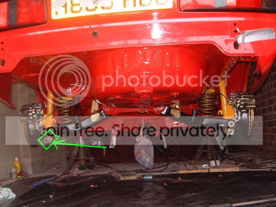

hi there,
does anybody know off the top of there head, the size the big sockets and spanners that are needed to remove all the rear suspention,
rear arms
anti roll bar thing
shocks
ect,
just the ones that are bigger than 18 mm will do, thanks very much, its apreciated
to strip the lot, as i need to change all the bushes

Think theres a couple of 19mm mate, i think thats the biggest used.

19 beam
17 beam plate
13 diff mount
19 shocker
13 anti roll bar
2 13 spanner for brake pipe
15mm socket prop shaft
13mm eshaust
think that cover is

cheers mate, i thought there was a big one on the end of the long bar things @ things,

there a 41mm on the drive shaft lh shaft is lh thread but you dont need to take that off if u r removing the whole beam

pic from, bodge,s resto,
this nut, i should have just done that in the first place,

i shouldnt of assumed it was a cossy
there 24mm

god its been a long time cud be 22 i carnt rember

thanks for your help mate, i will get both, and some 19 mm too, i was in a rush before when i posted, but my lift up halfrauds is comming back later
