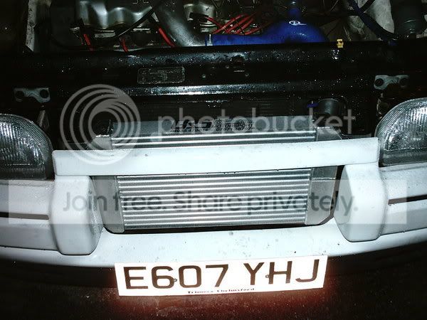

dunno if this will help as its the newest version of the grs but here ya go!!!
Theres also a pro alloy rad behind though.
