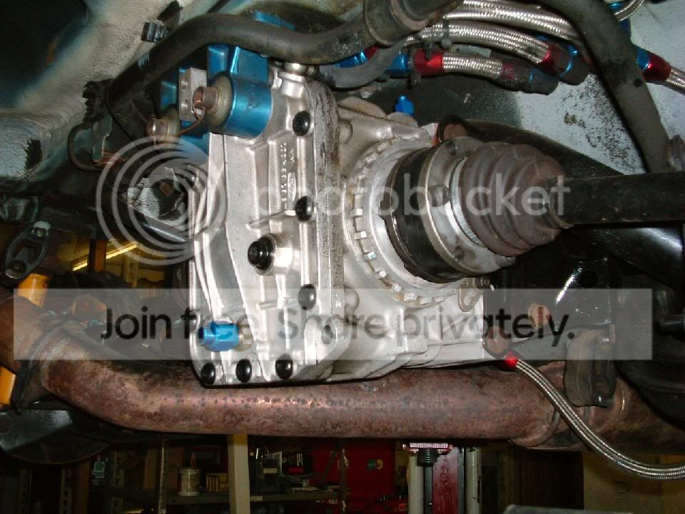

Originally Posted by Rs Gus
u also need the pump etc afaik dont u kev as the 9incher is dry sumped?????
no gus it has the fittings to fit an oil cooler though, which i dont have yet, it just fills as normal you might be getting mixed up with my gearbox it is dry sumped
