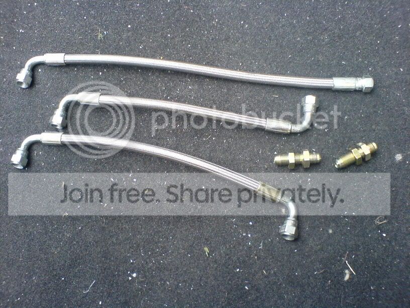

hi can anyone suggest anywhere to get braided hoses from to go in the engine bay. thanks

you have to make them up yourself
& make sure you use the PTFE pipe not just rubber braded
Assuming its fuel of course

where can i get it from who sell it as i know i got to cut it to size just want to know who sell it

Actually Mike, in the engine bay, it's totally unnecessary to run PTFE lined.

i also want to run a braided pipe for the fuel line to

Hi mate
www.thinkauto.com
they can sell you the -6 (dash 6) size hose for fuel. If you are running the lines under the car, use normal braided aeroquip FC333 hose. Absolutley no need for PFTE lined hose and the fittingsyou got off me wont fit either.
you need to take your fuel rail off and get male -6 unions welded where the std spouts are

cheers dave so i just the got to the fuel rail of and get -6 male welded on will pro alloy do it i take it i got to weld two on one for the fuel and the other for the fuel return
I just dont like the idea of fumes in an engine bay when you fire her up
Comes from boating good practise i guess
I have some dash 6 ptfe but if you have fittings off Dave No good to you

yep pro alloy should be able to help, if not, im sure martin hadland can
yes, two male unions.
THEN you need adapters for the fuel filter, rich pon can help you there.. then you're set to go as your fuel pump cradle is fully aeroquiped

dave sorry for all the ?????? i know u said i need -6 braided pipes for the fuel what other sizes do i want for the engine and thanks for the link
