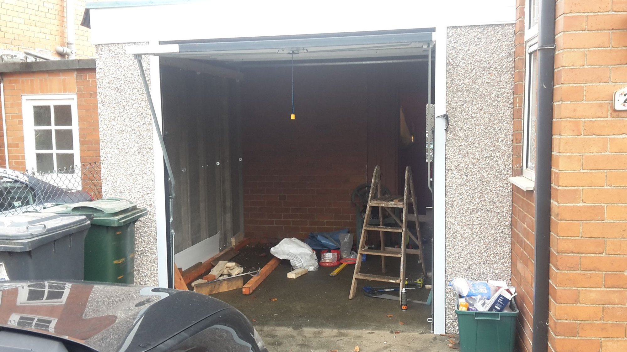

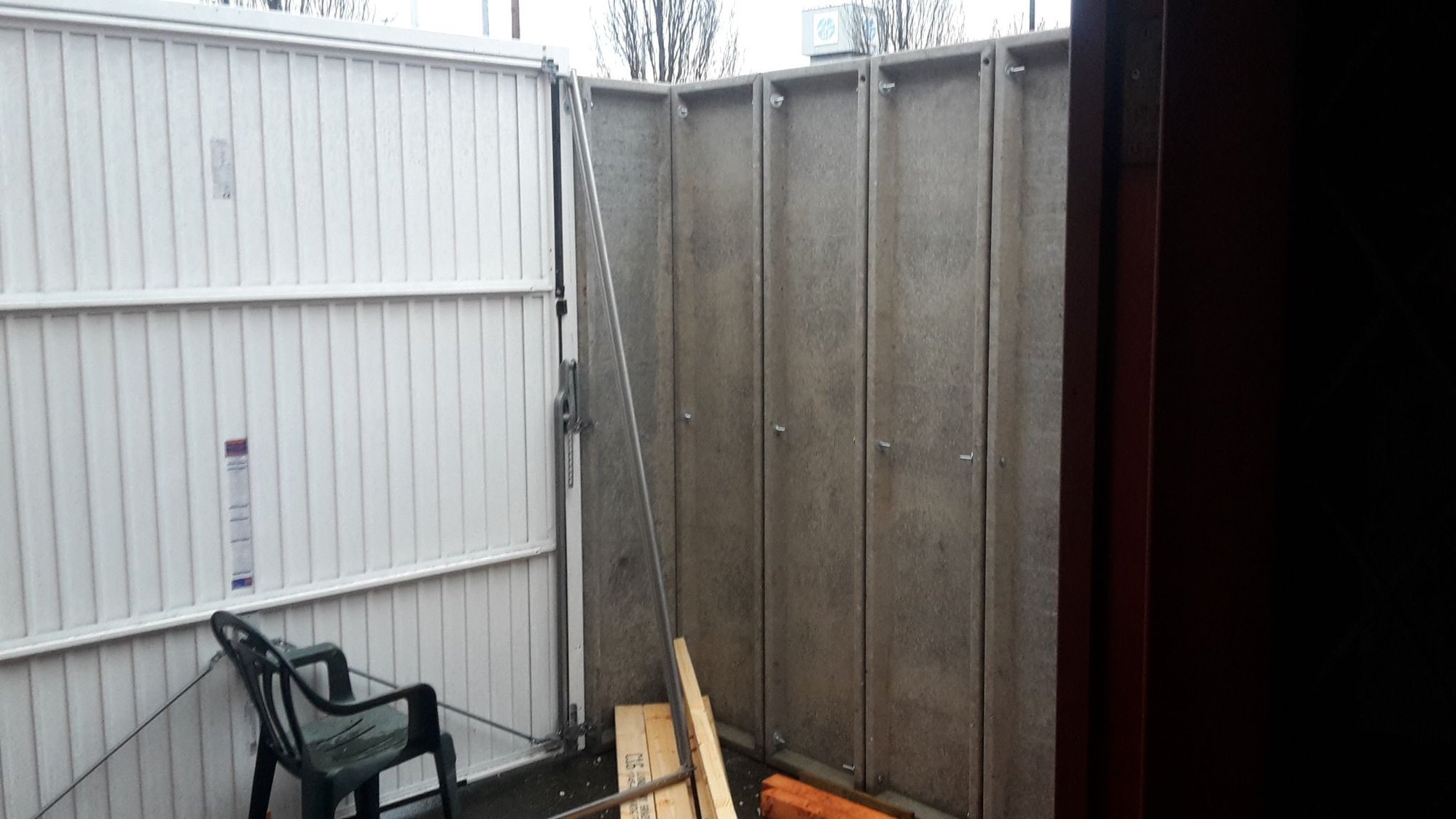

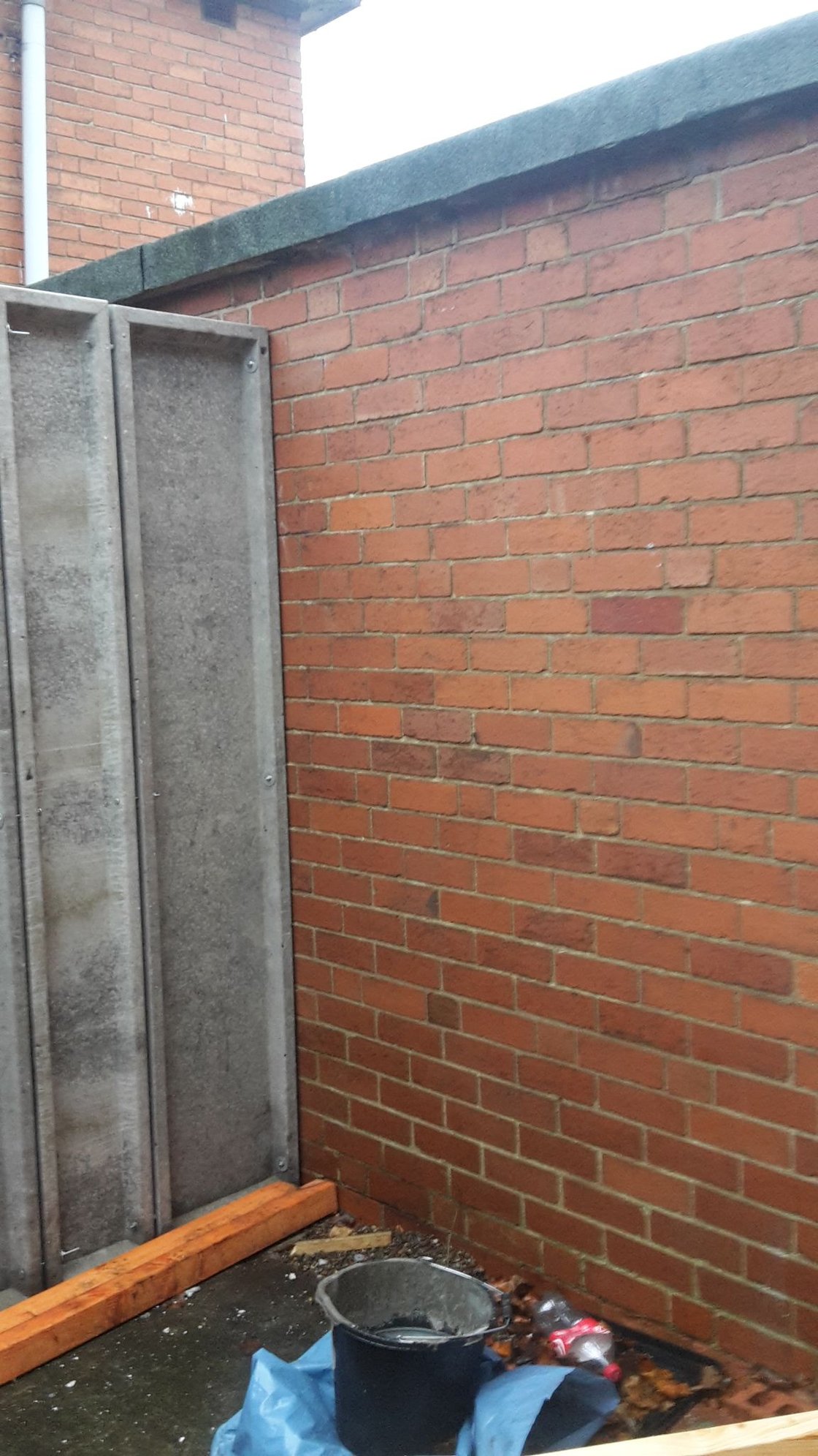

2 years ago i bought house and needed garage
it had 3 outbuildings attached with concrete roof
plan was to extend these and remove 1 outbuilding leaving an outbuilding for freezer etc and the toilet
but problem is i get bad condensation on concrete panels and concrete roof and door
any suggestions to help this wil be grately recieved

You need to be thinking about heat, ventilation and insulation.

Didnt want to heat due to costs but been thinks insulate walls and ceiling stop air hitting cold concrete etc and ventalation any ideas tips

Those bolt together types always do that, my friend insulated his and fitted vents and heating to solve it. I had a 5 car one when I bought my house, we knocked it down and did a normal build over it.

I think he glued foil backed insulation like celotex to the inside of it. He also added buttons on the outside and wood clad it but that was more to hide the pebble dash.
