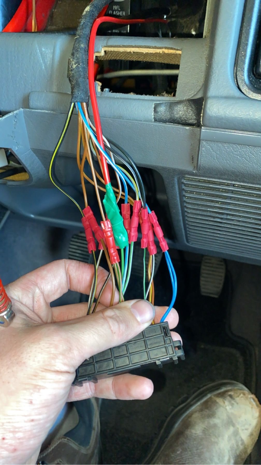

I have a 1989 1.8cvh Sierra with the dash cluster that has no tachometer and I have gotten my hands on another cluster from a left hand drive car before I go repin my plug and cut it for the new clocks will the Speedo work with the cable at the other side as it seems to have bend on it from hitting off the heater ducting behind the dash…and is it just a case of joining into green wire on ignition coil to get tachometer working
thanks in advance
