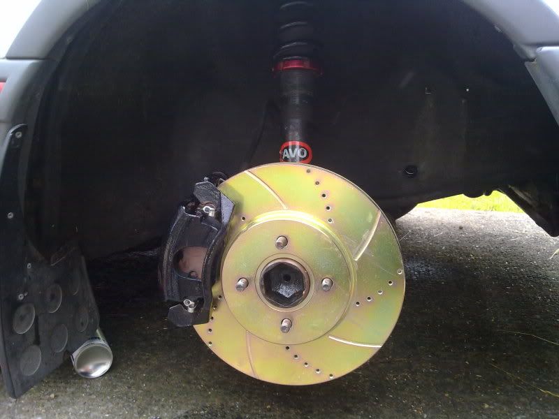

Does the ST170 disc with Mk3 Mondeo caliper conversion fit 2WD Cosworth hubs ?

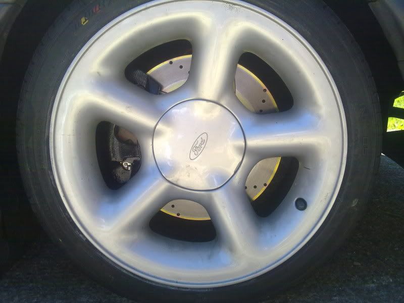

Really want to keep my RS 7 spokes...

I have fitted this conversion on my xr4i with no problems you just have to make a spacer up for UHF calipers and drill out the hubs for the bigger bolts

heres some pics
