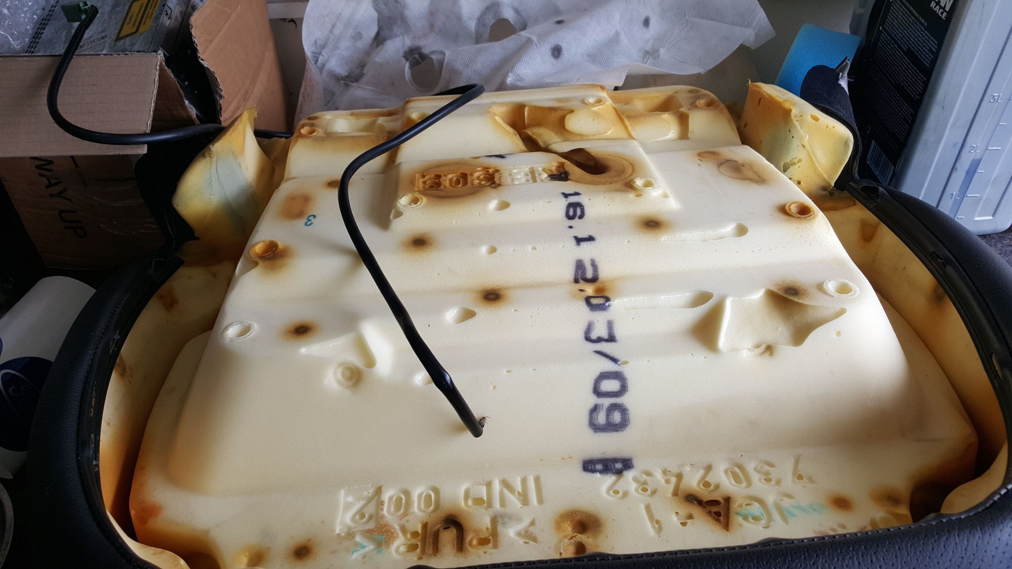

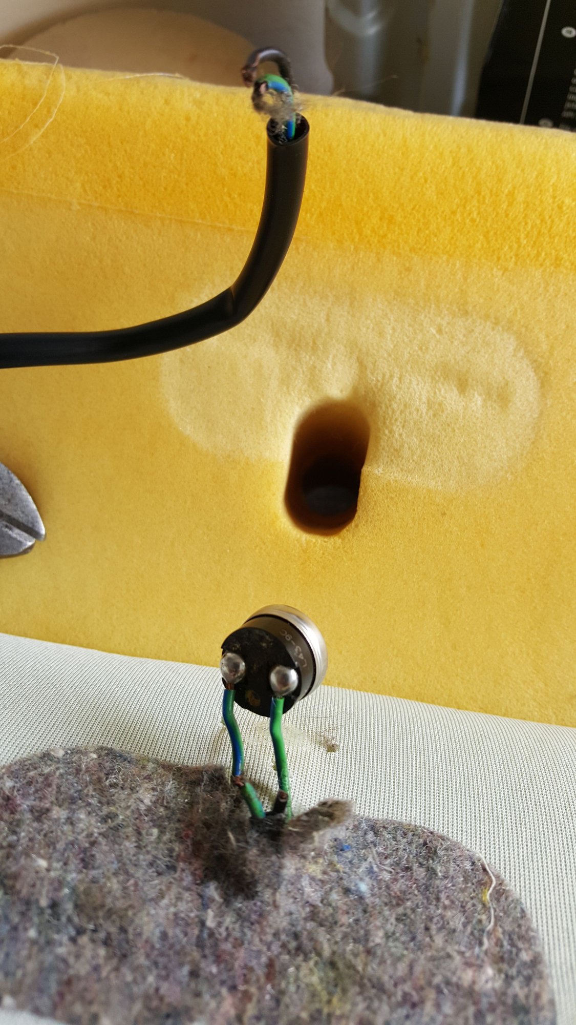

I had a look at my seats today. There is 2 connections under the seats 1 is for the seat back heater pad and the other for the seat base heater pad. Both seat base wires had snapped.
I folded the back of the seat cover back and could see the wires had just snapped. I soldered them together and there working again.
