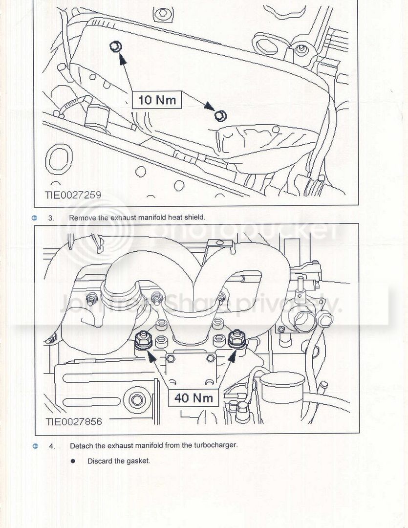

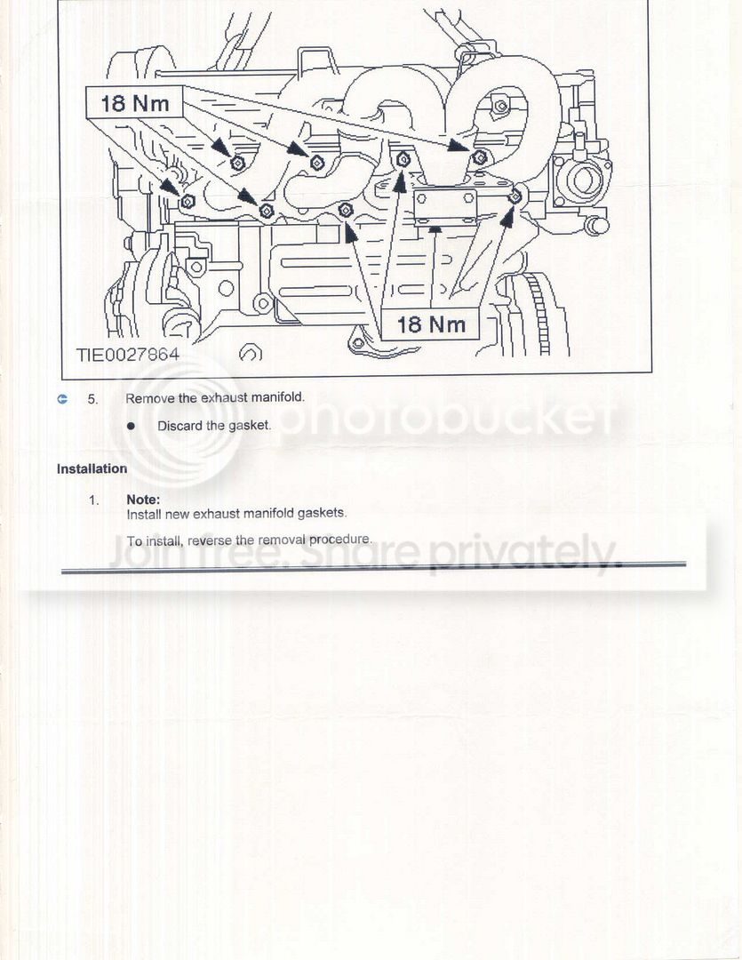

The Elmer supplied manifold is the original manifold that was to be fitted to the FRS, but they suffered from stress cracks late on the testing and a hurried cast manifold was made.
Saying that, nobody I know that has fitted one has had any problems with it.

I heard from a reliable source that Guido gets them from Wolf Racing, in which case I suspect they're made by them, copies of the original. Lost count how many times I've heard Guido say 'two left'.

Here is some picture from the TIS CD..................
Does anything look familiar.................

So should I Not buy one? Has anyone had any problems??

Is there a heat shield like the one in the pictures available for the Ford tubular item??

fusion can make you a heatsheild for it
i have the ford manifold and for the money its the best on the market
