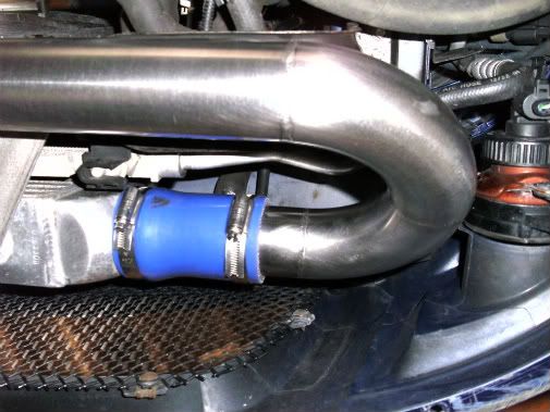

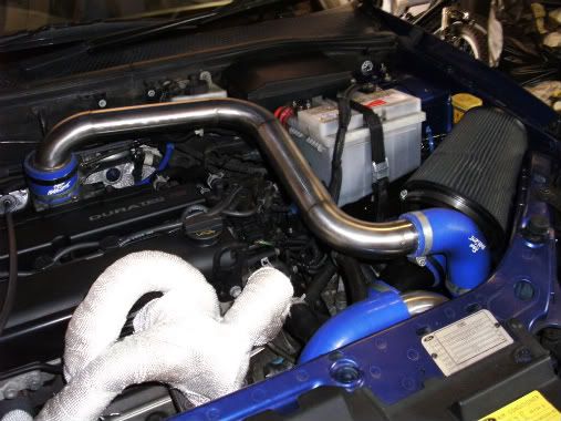

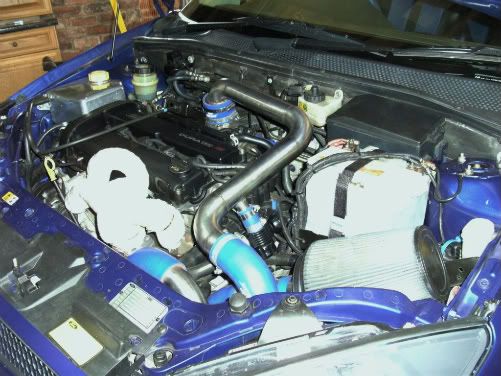

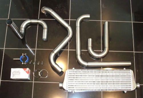

I make them for the focus RS
Take off for the recirc. valve...
Inlet side clears the fog lamp perfectly and fits flush with the radiator cradle...
Fewer silicon hoses are used and each angle in the pipework is stainless. This reduces the chance of future air leaks, although silicon hoses are used in stress points to enable flexible movement with the engine. Also fabricated an elbow from the inlet manifold to do away with the horrible cast one as standard.
