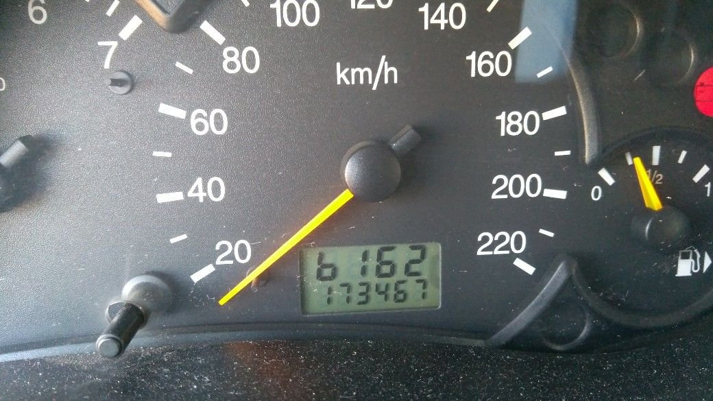

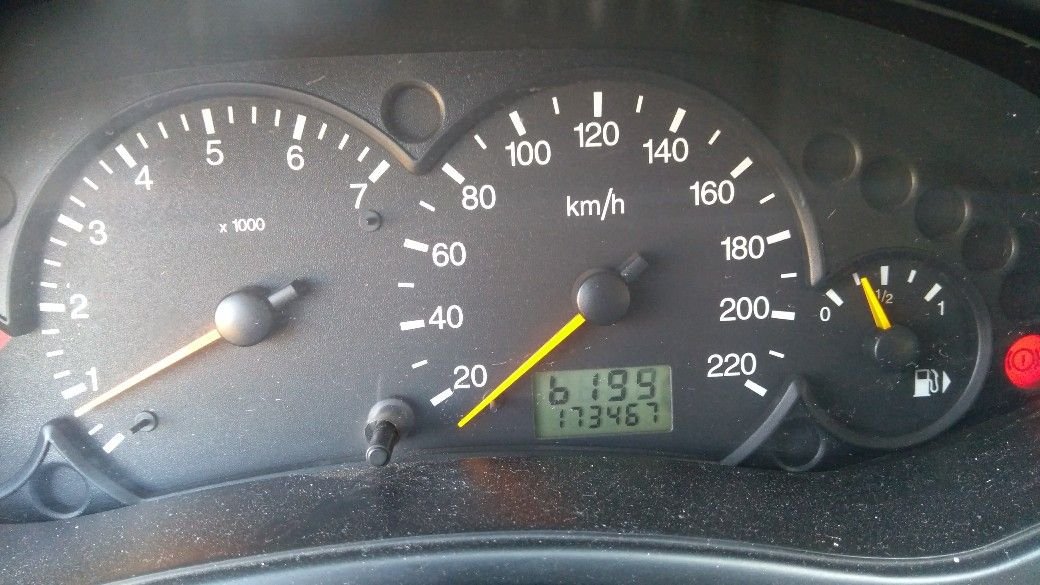

Hello. I have 1999 model ford focus ambiante.
my vehicle is trying to charge the battery at 15.5 volts.
Conjector changed twice with the original, but the problem was not solved.
The alternator has changed to its original (denso brand) but the problem is not solved.
my car battery has changed but the problem has not been fixed
my vehicle's ecu has changed but the problem still didn't fix.
help me. what else can i do for this malfunction???I see the line voltage incorrectly on my vehicle's gauge. pictures are attached. what should I do and where to check.

It can be normal for the smart charge voltage.
What is the issue? Are you in the correct section in the dash diagnostic?
