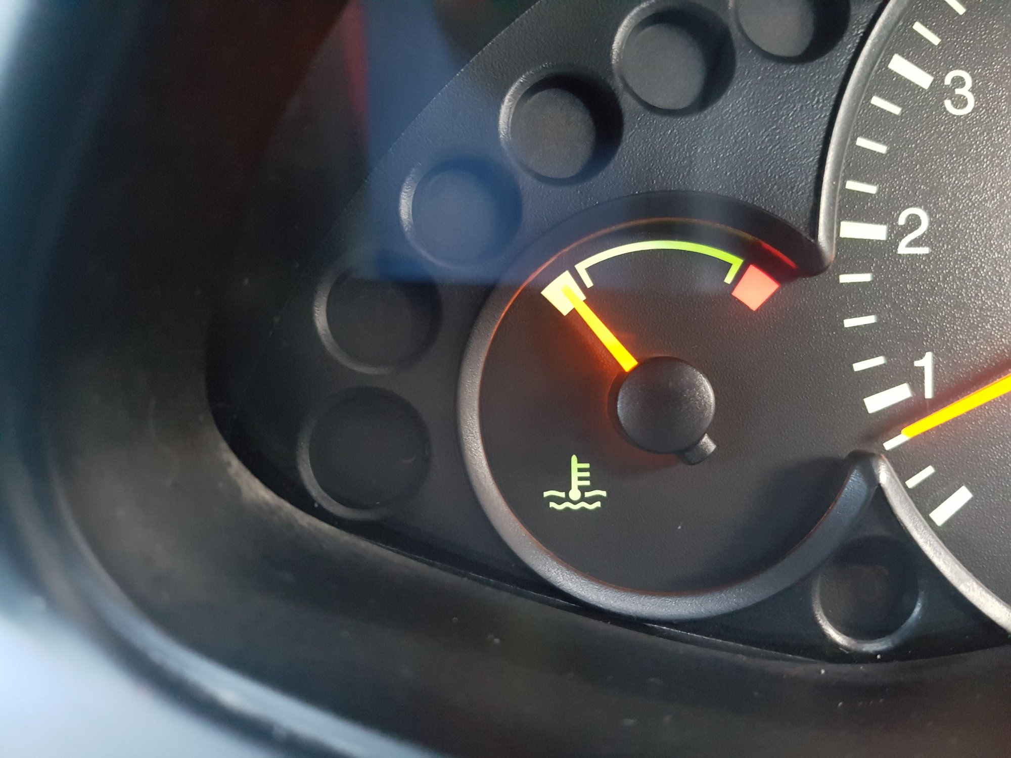

Drove to work this morning for the first time and the temp needle only just got to the first white line is this right or do I have to get my hands dirty....the pic is when I got to work which is 8miles away...
Any help would be appreciated

Possible stuck open thermostat, cheap to replace not a difficult job

Thanks mate that's what I was thinking. You replace the whole thing including the housing? Is that right

In this case yes, as the stat housing is plastic and they are prone to cracking.

ok so is this the right one for mine

Yes.
