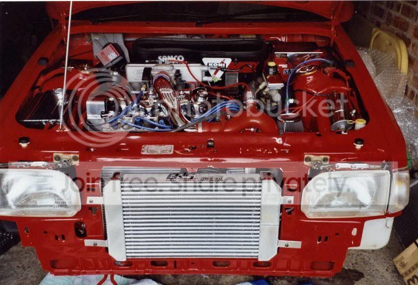

I'm thinking of buying a GRS Intercooler for my S2 anybody got any opinions of them are they worth getting?
Are they hard to fit and has anybody had any problems with overheating with one fitted?
Cheers.
Old May 22, 2004 | 11:59 PM
mattbibs's Avatar
mattbibs
Posts: 7,594
From: Lincoln
ive just fitted 1 to my frst. the best cooler on the market for a fez IMO.
the new evo4 is easier to fit for the escort & it looks the tits!
i havent had any overheating probs so far - touch wood!

but what abouit the fan(s), when u fit a GRS cooler.. do u fit them on the rad, or cooler... I have 2 8" kenlowe fans fittid on my rad now, wit std cooler... and I think mine i getting pretty hot??
Old May 24, 2004 | 04:39 PM
KSA-Cossie's Avatar
KSA-Cossie
Posts: 25,439
Likes: 19
From: Shutting down jap crap
fitted mine on the radiator too mate,best fit remote fan switch to though
Old May 24, 2004 | 04:55 PM
chewyS2RST's Avatar
chewyS2RST
Posts: 380
From: Buckinghamshire
rs adam- if you have fitted 2 fans to your standard rad you are bloking the
air flow thats probably why its running hotter,try fitting a fan switch insde
the car so you have more control over running temps.
GRS I/C are the biz,bit of a shit to fit but well worth the hassle IMO.
its a bit tricky if you are goin to mount the fan between I/C and rad,i found that
9mm of spacers between the I/C and front panel gave me enough room
to fit the fan in between the both.

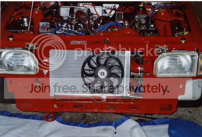

you guys need a pro alloy cooler!
http://img77.photobucket.com/albums/...zer/rs2fm1.jpg
Old May 29, 2004 | 12:50 PM
vroooom ptssssh's Avatar
vroooom ptssssh
It Wasnt Me!
Posts: 22,752
From: Scottyland
wont be much airflow to that with them fans on the front wazzer
Old May 29, 2004 | 04:43 PM
wayneclayden's Avatar
wayneclayden
590 BHP/Ton
Posts: 1,670
From: Haverhill,suffolk
"wont be much airflow to that with them fans on the front wazzer"
The figures are good... The test car was fitted with a 'popular' alternative(shouldn't say which!) and we saw 71 degrees with an ambient of 24 deg...
this cooler never went over 54 deg. both tested on the same car on the same day..ok this car was a bit of a nail, runing way too much boost, with no where near enough fuel-but it gve us a good comparison.
The twin fans are there to make shure the water temps are stable at all times(traffic etc.) way too many people get carried away with air temps and forget the water- the best way is to have a good all round balance.
ps.. the air scoop plate on the r/h/s can be removed and replaced with our bolt on turbo cooler- If you wish!
