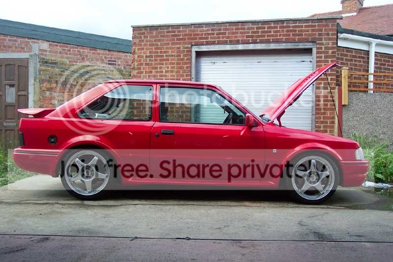

i rekon 30mm m8 as the ride height is still nice and comfy yet sporty enough for fast road driving...and the car looks sweet as with that drop...got a pic somewhere...
here ya go
and heres mine with a -45mm drop on the front only with 17s
HTH

mitch - red one does scrape with the rims on the arches on the back a touch when alot of people are in the car or when cornering VERY hard apart from that its fine...or if your talking about the exhaust, nope its fine generally but i get the odd few bumps here and here where it does scrape...however i am running a 3" bore exhaust as well
