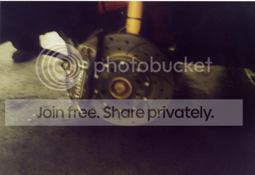

Are the Cossie discs you buy from MadForIt Cross drilled/Grooved?
They are drilled mate... this is the conversion on mine (on mad for it's roller) - You can't make the drilled hole out - cos the wheels/discs are going around at time of photo
BTW Would agree on having standard pads - the race spec/uprated ones need the car to be driven hard ALL the time - as they have to be hot to work well.
