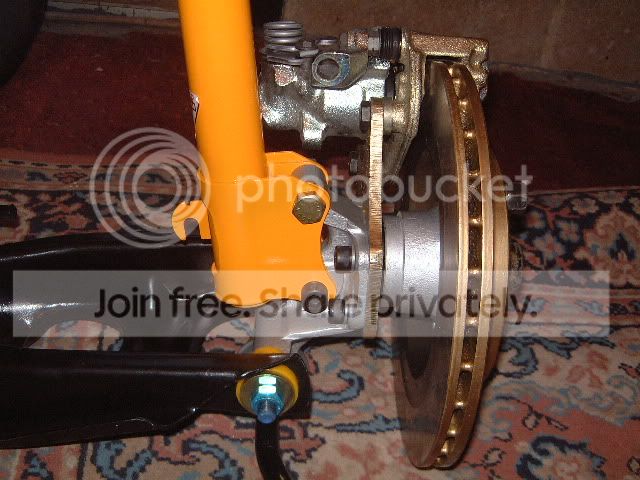

you will need brackets for it m8 and dont think there the same as used for 2wd but i may be wrong??
heres mine with escort cossy rears
mark

oh and see from the pic theres a spacer to center the calipar to the disc
i got my set up from clint off the RS site, he may still have or get the brackets and spacers
mark

Yea, get the setup off cossieclint, he does the whole kit, and good luck drilling out the holes for the bolts to go through from behind to hold the bracket on, wow that's tough!

mine drilled ok was as soft as butter
dont drill fast do it slow
mark
