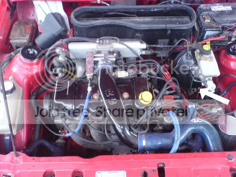

It will start eventually but i have to just to hold her starting, if that makes any sense just keep on turning her over. After reading previous posts i have checked the flap on the metering head and it is flapping as it should. However there was smoke coming from these wire's where i think the casing has melt after a long period of contiued starting. What wires are these and were do i get new ones?

mate can u get a close up of those wires please as it looks like its pointing to the brakes lines

if that arrow is pointing to what i think it is then thats the pipe for the fuel accumulator, if thats melted then that will cause problems
