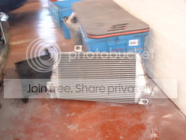

Would a EVO 4 intercooler fit my S2? As i have one. Its a single pass number, so id have to make the cross over pipe go the other way

I think Warley Daddy fitted an Evo4 cooler to his S2 many moons ago, PM him. He may be able to help. I know a few people have fitted Evo intercoolers before.

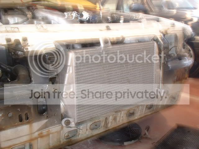

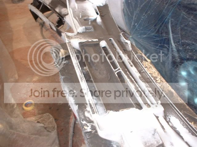

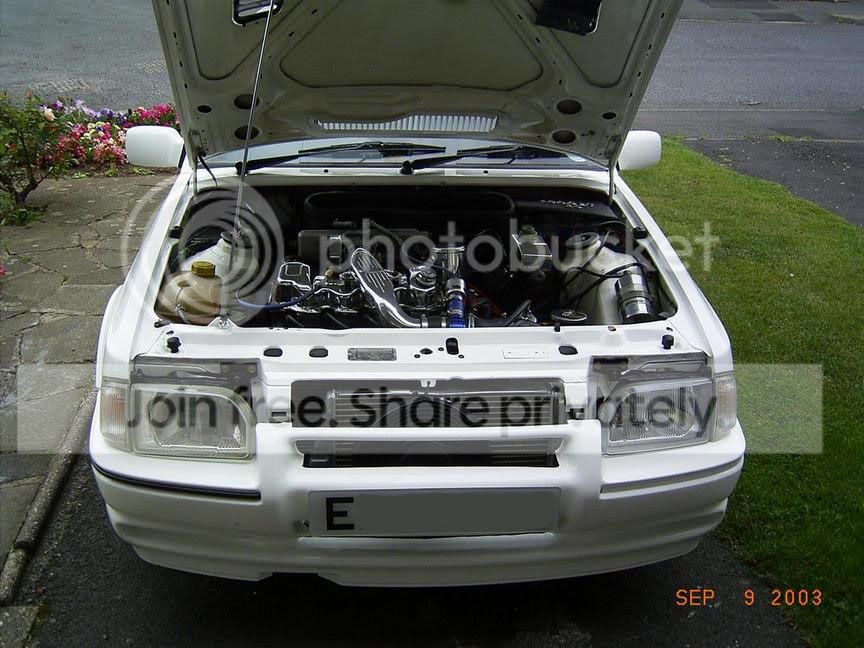

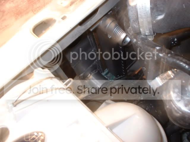

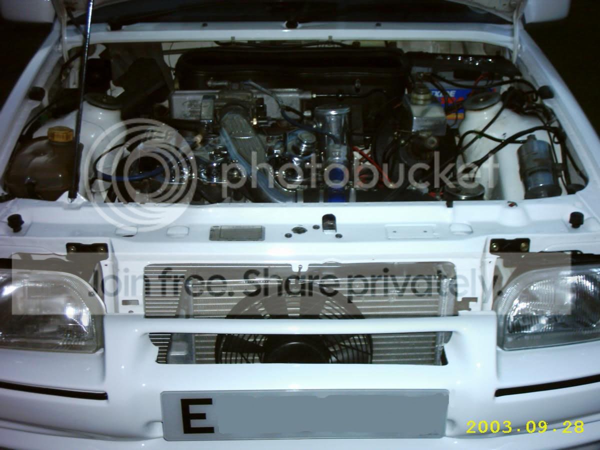

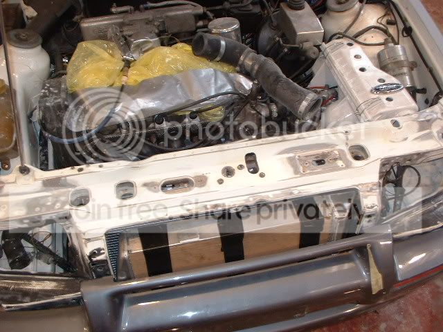

Yeh i did it AGES ago!!!!!!
Had end tanks converted....

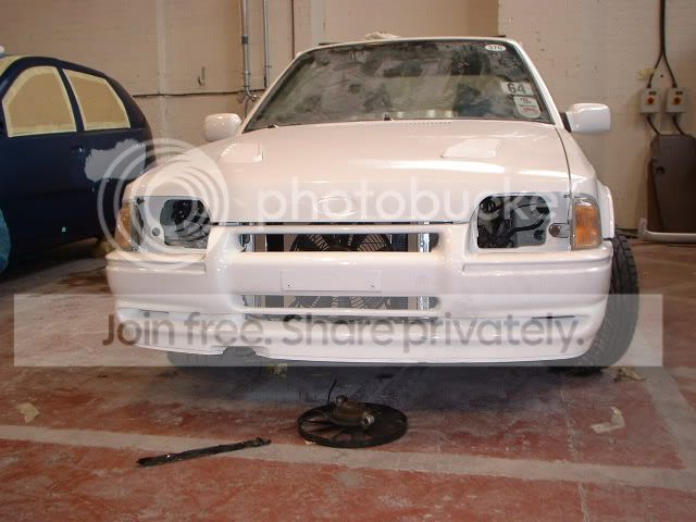

Had to shave out all the inside of the bumper,as i didnt want,and DONT LIKE the cut of front bumper style!!!!!
Last pics i had,cable tie went,and made a little bracket to look better...
Good luck if you try it..
Pete...

Actually looks quite a good fit

Its DAMN tight mate,but well worth it...
We did Tony C`s and Stu H`s the same,and we were seing 3/4degree ACTS!!!!!!!
