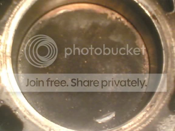

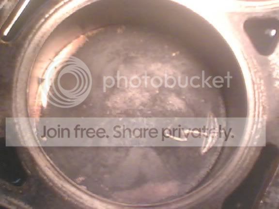

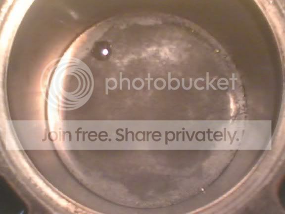

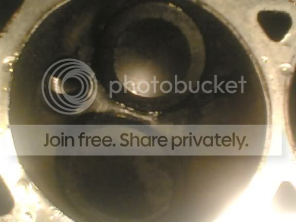

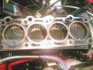

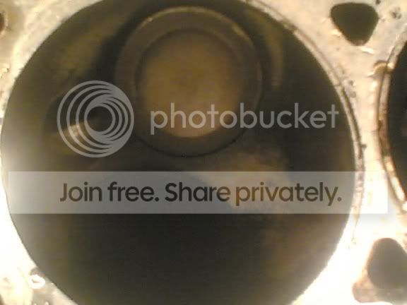

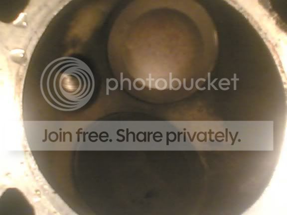

****UPDATE 29/11/05****
Whipped the head off yesterday and here are the pics below,not sure
how good they are going to come out because they were taken on a camera phone, but all 8 valves have hit the pistons
1 and 3 seemed to be the worst,so i guess time now to strip the head down and see how many(probably all)of the valves will need replacing.
