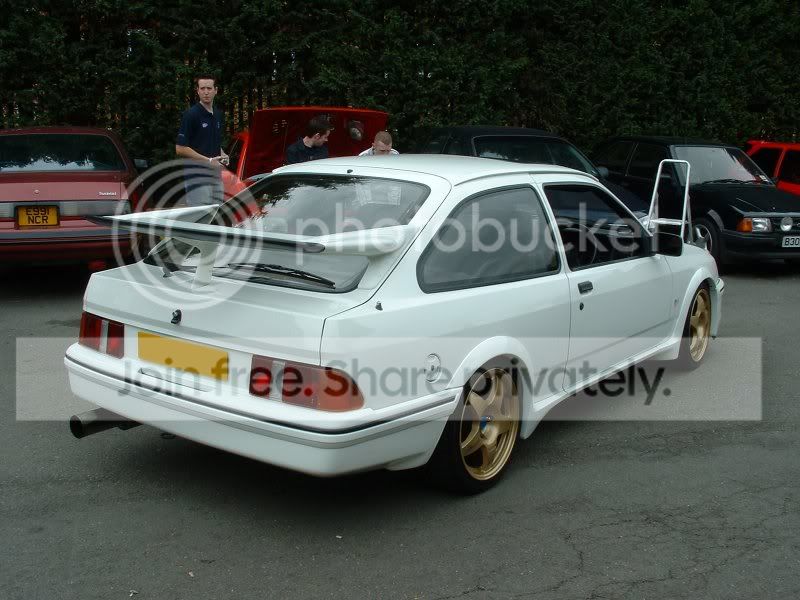

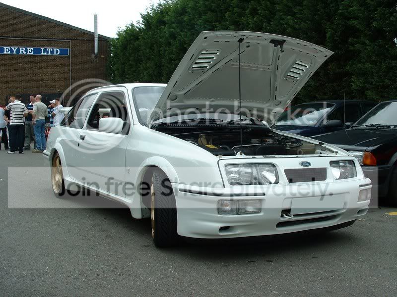

mine are et35 8" on the rear and et37 7 1/2 fronts
there ok at filling the arch, but only in a way as to not cause any rubbing issue's
you can fit et25 8" rears but may need a bit of trimming
heres a couple of angle pics, hth
and this one cos i like it,lol
