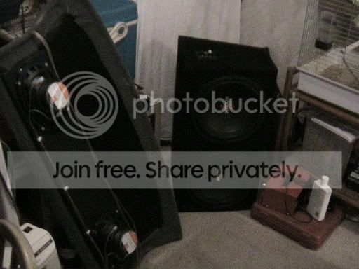

It's not ideal mate you should have your power cable to the boot and a distribution block then feed the amps from the distribution block.
Pics of the install on my RST Perhaps I should have taken some before removing it all.

nice
gone for the weight reduction now then...
