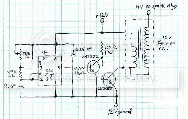

so its best to fit them in the pipe just before the back box yes???
ive almost finished building my prototype one.

you can build them yourself from bits (maplins etc) cost bout Ł5 + coil, lead plug......... dead easy

thats what im doing mate, just gotta find some one that can supply coils at trade price

i finished making the circuit i was on about today, didnt fookin work,
it wont switch, just stayed high all the time and the transstor got fookin hot!
anyone got any flamer circuits i can use?? (wiring diagrams...)
Old Jul 2, 2004 | 12:07 AM
Fudgey's Avatar
Fudgey
Baby Cheesus
Posts: 20,134
Likes: 106
From: Wiltshire
this is the circuit i used courtesy of gareth t
need one that works tho...

I dont understand the circui diagram.

well, i built it yesterday, and put an oscilloscope accross the 555 and it switched ok, but when the load was added the transistor stayed high and foookin hot, it wount not spark either, but it did if i kept touching the wire of the coil onto the output...
