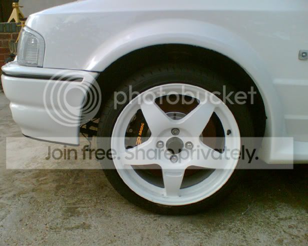

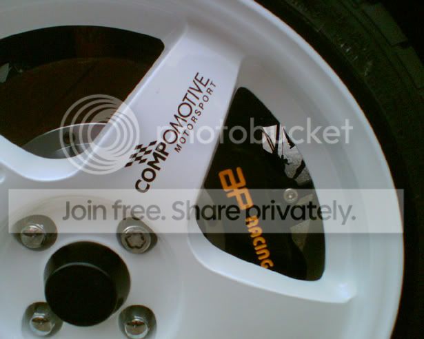

AP 4 pots 330mm bells are rotors
Or, before that I had 2wd Cosworth discs and re- conditions S2 calipers on the front, with 2wd Cosworth discs on the rear, and a mate said that my brakes were as good as his AP 4 pots on his Saph. They were very good brakes for not a lot of money. Just make sure you have taken off the ABS, that will make your brakes a whole load better.
